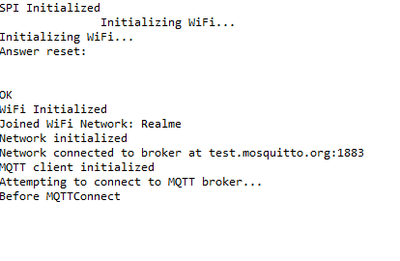

hi @hayat I need assistance in initializing an MQTT connection from STM32CubeIDE to connect with a cloud platform for the BL4S5IIOT01A board. I am facing difficulties in connecting the client with the broker.
this is the output i am getting i have attached the main.c file and for this project i have used paho mqtt package(https://github.com/Doawen/paho.mqtt.embedded-c.git).
