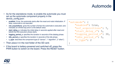

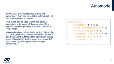

If so, we're already implementing such a feature and we called it “automode”.
Here a couple of screenshots from the Quick Start Guide to guide you enabling logging in loop:
I suggest you take a device_config.json from a previous valid acquisition (or from the acquisition example folder available in STDATALOG-PYSDK).
Then, modify the “automode” section only by modifying the values you need.
