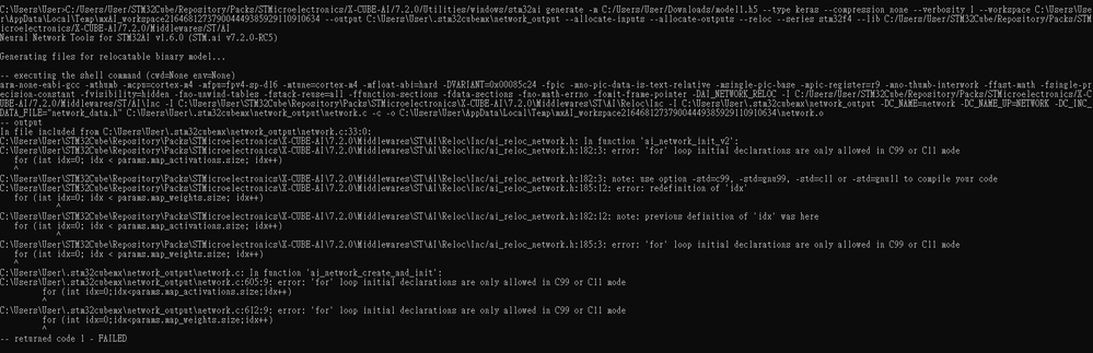

As shown in the picture, when I send the generate command, a compilation error occurs. The problem appears to be that std=c99 needs to be adjusted.
Does anyone know how to fix this please?

What version of the arm-none-eabi-gcc are you using ? (arm-none-eabi-gcc --version should do the trick)
Also what is the location of the arm compiler you are using ? Is it the one provided with STM32CubeIDE ?
To help debugging you can try to execute the arm compiler command manually with the -std=c99 option (the line after "executing the shell command (cwd=None env=None)"

Thank you for your reply, I found out that the old version of arm-none-eabi-gcc in the environment variable is used.
Now the relocatable binary model has been built successfully.
