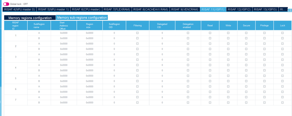

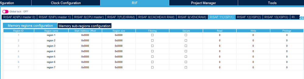

2025-05-26 8:37 AM - edited 2025-05-27 1:08 AM
Hello @SlothGrill!
I checked and there was an entry in the memory pool related to the xSPI1, moreover its use was enabled in the memory ram tab. I removed the entry and disabled its use but nothing changed. I also checked if in the generated code there was some line in which the program tried to R/W the external memory but I found nothing.
As for the RISAF, it is configured as in the pictures:
I'm attaching the code, the ioc project and generated binaries if it could be of help.
