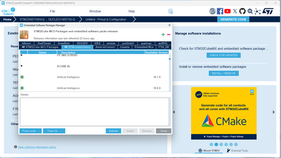

2025-05-21 5:19 AM
Hello @Dresult,
I don't really understand why it asks for the zip when you select X Cube AI?
The version 10.1.0 of X Cube AI is out, do you have it installed? Maybe, if you only have the 10.0.0 it creates strange behavior?
Could you try to install the version 10.1.0 from the main page of CubeMX and try again? I cannot reproduce your behavior.
You may have to try uninstalling every version of the X Cube AI inside CubeMX to see if it helps.
Have a good day
Julian
2025-05-21 8:14 AM - edited 2025-05-22 12:08 AM
Hi @Julian E., thank you very much for your reply!
I've updated to version 10.1.0, however, if I make a new project and try to use X-CUBE-AI I still get CubeMX freezing. A temporary solution I am exploiting is using the XIP template from this GitHub repository: https://github.com/stm32-hotspot/STM32N6_FSBL_Modes/tree/main
With that, when I am asked if I want to set the clock and peripherals for improved peformance everything works smoothly.
On the other hand, there is an issue when trying to compile for the Neural-ART: when I try to analyze the model, I get an error with the following output:
