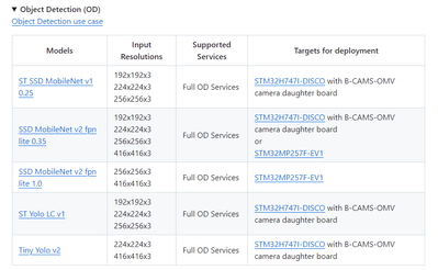

Hello @Ritesh1 ,
In model zoo you can find 2 yolo architectures, with different resolutions:
If you want a resolution that is not listed, you will have to learn how to change the input size of a model, in a few words, it will consist in:
Depending on if the model was done with tensorflow or pytoch, the python code to do that differs.
You can find tutorials online to do that.
