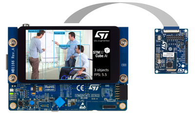

I’m working on deploying my custom tiny ISSIMO-V8 model for object detection onto the STM32H747I-DISCO board with the OMV CAMS camera. Can I use the FP-AI-Vision 1 project, which is based on object detection for people counting, and modify it to adapt to my model (detecting kitchen utensils and multiple objects)?

Hello @syrine,
You should look at ST Model Zoo for object detection: https://github.com/STMicroelectronics/stm32ai-modelzoo/tree/main/object_detection
And in particular, the deployment operation mode that allow you to deploy your model on the STM32H747I-DISCO that you happen to use: https://github.com/STMicroelectronics/stm32ai-modelzoo/blob/main/object_detection/deployment/README.md
When using the deployment operation mode and scripts, it will modify the application project located here: https://github.com/STMicroelectronics/stm32ai-modelzoo/tree/main/stm32ai_application_code/object_detection
So you can have access to the source code (the deployment scripts directly flash your board)
Have a good day,
Julian
