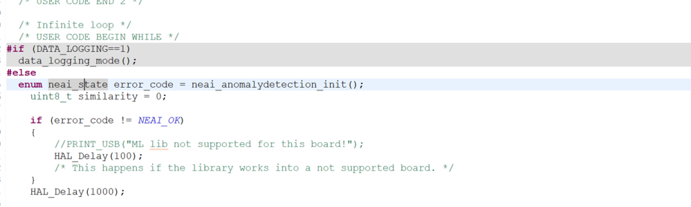

The thing is I cant run ml models optimised for stm32l412rbt6p in stm32l412rbt6 as shown in code below.

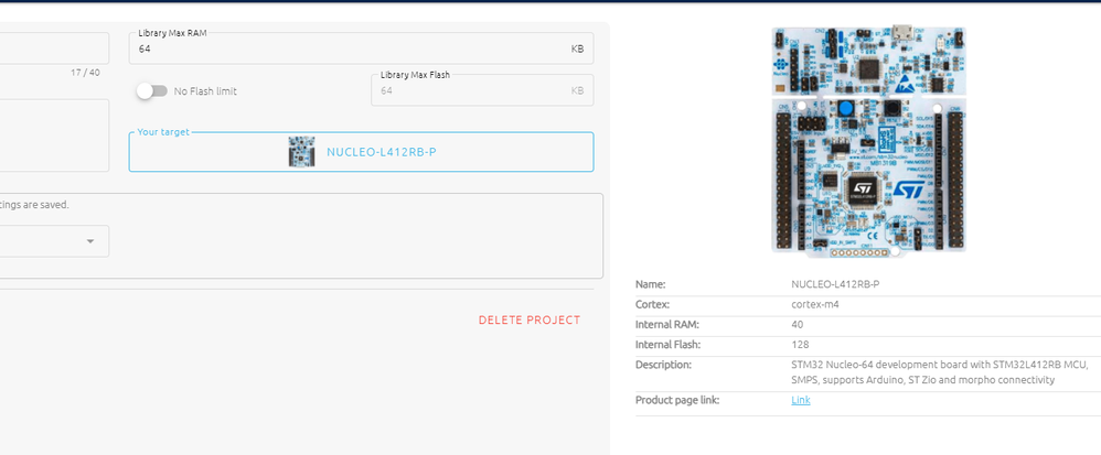

I want to have access to stm32l4 mcuml models which is currently locked by nanoedge-studios.I have also posted screenshots for your reference.

You can use NanoEdge AI Studio for free with development board. However, this does not apply to custom PCBs. For custom PCBs, please contact NanoEdge directly.
Best Regards,
