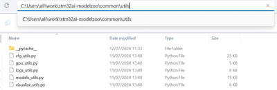

it is a custom library by ST located at \stm32ai-modelzoo\common\utils, not the log_utils from standard python library. Try running the demo from notebook stm32ai_model_zoo_colab.ipnyb located in \stm32ai-modelzoo\tutorials\notebooks\. Running train.py is not successful on my system. I have run and deployed using the notebooks. The deploy notebook is at \stm32ai-modelzoo\image_classification\imageclassification_deploy.ipynb. Though the model is not performing as good.
