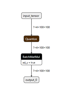

Hello. I am currently attempting to execute a MatMul operation on an NPU. I have implemented a simple TFLite file with a MatMul operation, as shown in the image below.

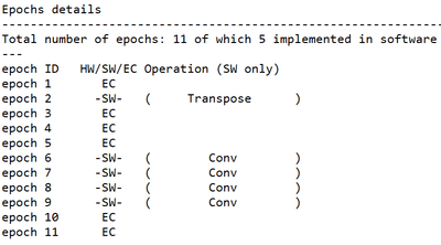

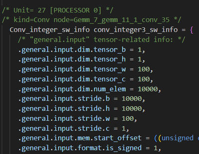

When converting the model using ST Edge AI, I observed that Matmul operator is mapped to the MCU instead of the NPU, and the operation is converted into a Convolution. Furthermore, checking the network.c file reveals that it is being converted into a convolution layer with an extremely large stride.

In your case, you use batchMatmul. Batchmatmul and matmul are two different operators. The Batch matmul can be seen as a concatenation of N matmul with N="batch", That's why we end up with 4 different convolutions, and for the moment, we have the same constraints of the matmul on the second input that should be constant.
So you should try to have a constant second input to see if it helps.
