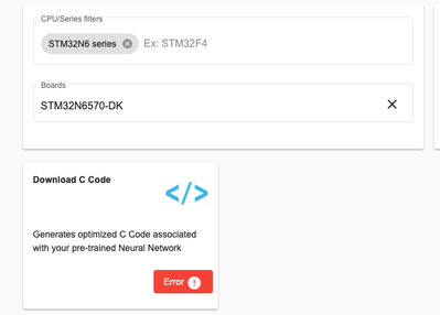

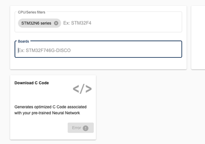

After the latest update, I can't download C Code from Edge Ai Developer Cloud, there are no boards in the list.

This is indeed the case. it seems to be a bug for now.

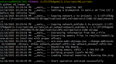

Note: if you unplug the N6, you will need to reflash the validation firmware with the n6_loader.py before running the validate command.

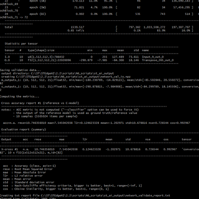

by default, it uses random data as input. It would be better if tested on a real input dataset using the option: -–vi dataset.npz
It can take quite a while, but you should get something like this:
