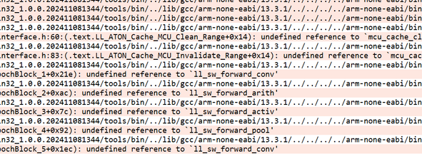

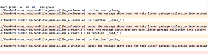

2. When I tried to build the project (and I didn't change any of the generated code), linker garbage problem occurred as shown below. For project of STM32F407 in Keil MDK, I solved the problem by changing the C language compilation mode.
Also, there were so many undefined references. In theory, problems like this should not occur when using X-CUBE-AI.

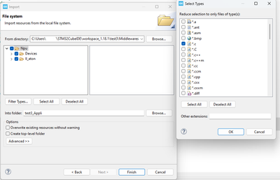

Hello @Levy-hy,
You can ignore the first image errors.
For the second one, it happens that the AI libraries are not correctly set in your project.
I think this should help you
Have a good day
Julian
2025-07-22 3:34 AM
This has nothing to do with "garbage collection".
Concentrate on the second image, which lists a lot of "undefined references".
There are functions you call, but which are not implemented anywhere.
Either you forgot a source file, a library, or got the wrong library.
You can use the command 'objdump -t <libname.a>' to view all the symbols a library exports.
The 'objdump' command must of course correspond to the target architecture.

2025-07-24 7:52 PM
THX! I forgot to import the ll_aton library and now it works out.
