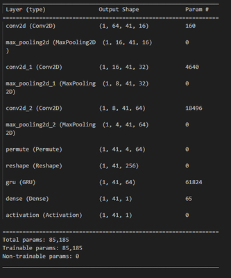

# Summary of the model
model.summary()
(as explained in the doc, you need to define a batch size of 1 and put stateful=True in the gru)

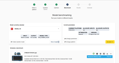

When I upload it on ST Edge AI Dev cloud, I cannot quantize it but the optimization pass and I succeeded in benchmarking it on a real board:
So you should be able to use it as of now non quantized if you want, it may be useful to you.
