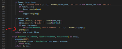

in Your_Model_Zoo_Folder/common/stm32ai_local/utils.py can you add "print(lines)" at line 306 like so:
Can you please run the script again and send me the message complete log.
