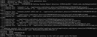

Dear ST Team, I'm trying to deploy models on STM32N6570-DK, and there is the issue:
Followed tutorial below:

building.. Debug
flashing.. Debug STM32N6570-DK
Board programming failed: ""
Error executing job with overrides: []

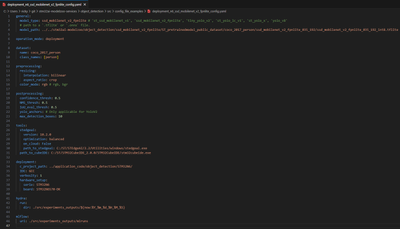

And this is the YAML file I edited:
Furthermore, example binaries in stm32ai-modelzoo-services/application_code/ works fine via CubeProgrammer, but failed when I run model-zoo-service python script.
How can I deal with the issue?
