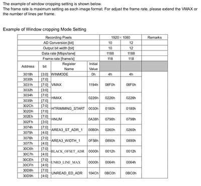

2025-06-30 5:08 AM - edited 2025-06-30 5:15 AM
I was able to change the frame rate using the following formula I found here.
The formula I used -
frame rate = inclk/(vmax*hmax)
However, I have a few doubts regarding this.
According to the IMX335 datasheet (page 57), we have:
VMAX = 0x08F0 = 2288
HMAX = 0x0226 = 550
INCLK = 74.25 MHz (default value)
frame rate = (74.25 * 10^6)/(2288*550)
= 59.003
But the datasheet mentions a frame rate of 118 fps for this configuration.
My question is:
Where does this factor of 2 discrepancy come from?
Is it due to the internal PLL within the sensor mentioned on Pg 9?
Kindly help.
