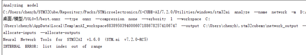

I trained a yolov5 model and export it to .onnx model. Then use xcubeai to analyse it. But I get an error 'list index out of range'. What should I do?

We have identified the root cause of the issue, the model contains a 5D initializer that is not fully supported by our importer yet.
