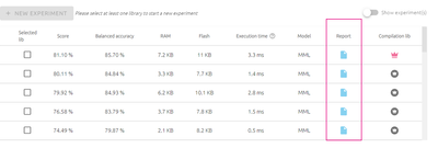

You can find the report in the validation step here:
And the flow chart at the end of a report:
Please let me know if you have any other question.
