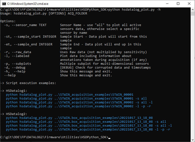

First, I suggest you launch the scripts within your Python environment with the -h option. You'll see the helper with the description of supported features and the full list of optional commands and parameters. Here is an example:

Hello @SimonePradolini
Thank you for your help! I tried the solution you suggested, and it worked perfectly. The hsdatalog_data_export.py and hsdatalog_to_nanoedge.py scripts were exactly what I needed. Running them with the -h option also helped me understand the available parameters better.
