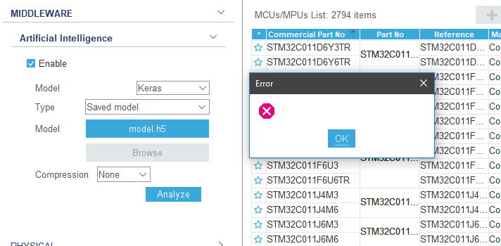

Hi is it normal this error when IA Analyzer is used?
Any error appears...
thanks for your time.

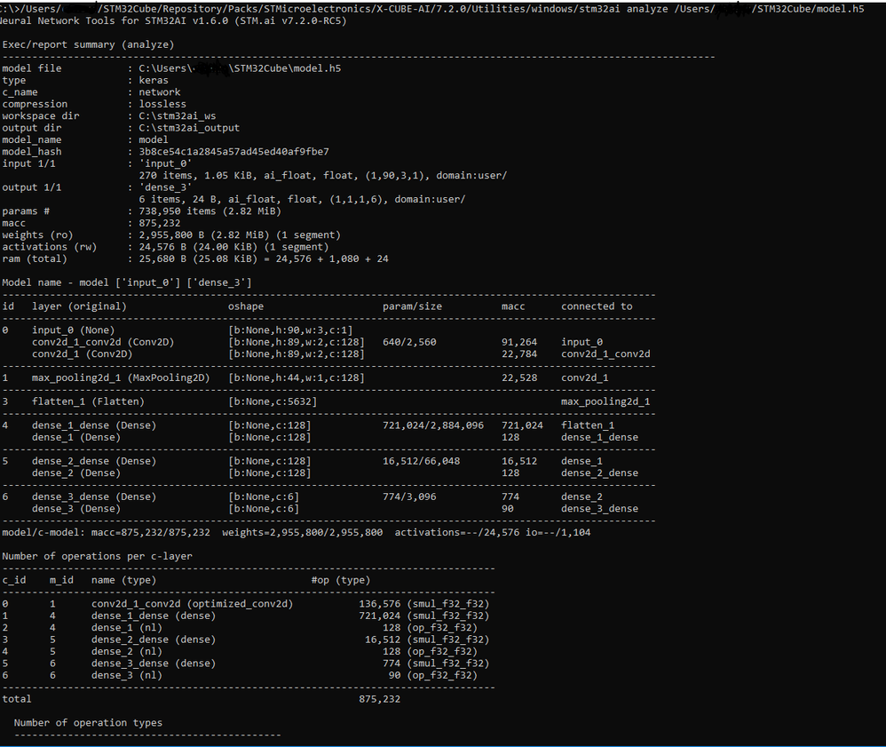

2022-08-25 3:25 AM
In Command System, it works..Any idea?
I am working on Windows. It looks like any bug in CUBE mx application.
Thanks for your time

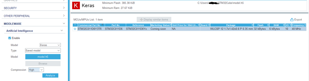

2022-08-25 5:48 AM
That works when CUBE ID wa installed.
The only question now is why flash need is higher than the tutorial showed.
