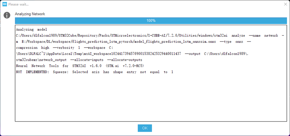

I've created a model which consists of only a LSTM layer and a linear layer with Pytorch, and convert it into ONNX model. But when I tried to verify it with STM32Cube.AI, it just print "Not IMPLEMENTED: Squeeze: Selected axis has shape entry not equal to 1". As I've checked the model, the shape entry which I try to squeeze is 1, what may the cause the problem? Sincerely for your help.

Thanks for reporting this issue,
We had an issue with this model due to the insertion of a Transpose layer before and after the LSTM. This determines a wrong shape inference for the successive layers depending on axes (e.g. Squeeze).
We have fixed the problem in our upcoming 7.3 version that will be public by beginning of October
