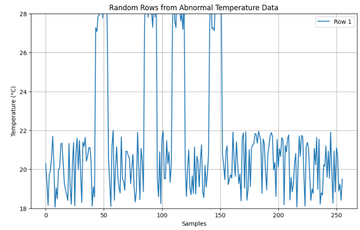

Abnormal temperature data (randomly generated)Abnormal temperature data (randomly generated)

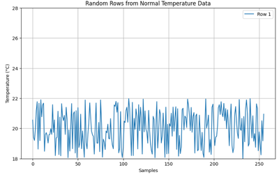

Normal dataNormal data

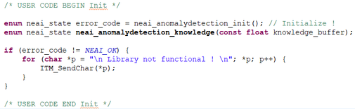

Following the documentation in order to implement said detection model under STM32CubeIDE, I chose to use the knowledge used while benchmarking the different models, as I don't have a way to get real data yet :
Model initialization with knowledgeModel initialization with knowledge

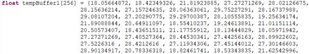

No errors up till here. In order to correctly determine whether my model is functionnal or not, I chose to use a random buffer of samples generated using the Python Code (just for illustration purposes, here below is an example) :
Abnormal buffer of samples (example)Abnormal buffer of samples (example)

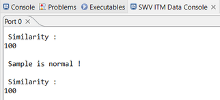

Unfortunately, whether I'm using an abnormal, normal or even an array with only constant values, the similarity was always of 100 :
Anomaly detection resultsAnomaly detection results
