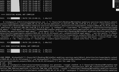

I'm currently deploying the object detection of stm32modelzoo. After entering the command "python stm32ai_main.py --config-path ./config_file_examples/ --config-name deployment_n6_ssd_mobilenet_v2_fpnlite_config.yaml", an error occurred. Could someone please help me solve it?
imization 3 --Os --Omax-ca-pipe 4 --Ocache-opt --enable-epoch-controller --output-info-file "c_info.json"
PASS: 91%|█████████▏| 84/92 [01:21<00:12, 1.60s/it]
<<<< DONE EXECUTING NEURAL ART COMPILER
PASS: 91%|█████████▏| 84/92 [01:24<00:12, 1.60s/it]
PASS: 92%|█████████▏| 85/92 [01:25<00:16, 2.35s/it]
LOAD ERROR: WindowsPath('C:/Users/dell/Desktop/N6/stm32ai-modelzoo-services-main/object_detection/src/experiments_outputs/2025_05_15_18_41_52/network.h') and WindowsPath('C:/Users/dell/Desktop/N6/stm32ai-modelzoo-services-main/object_detection/src/experiments_outputs/2025_05_15_18_41_52/network.h') are the same file

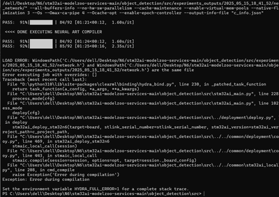

Error executing job with overrides: []
Traceback (most recent call last):
File "D:\python310\lib\site-packages\clearml\binding\hydra_bind.py", line 230, in _patched_task_function
return task_function(a_config, *a_args, **a_kwargs)
File "C:\Users\dell\Desktop\N6\stm32ai-modelzoo-services-main\object_detection\src\stm32ai_main.py", line 228, in main
process_mode(cfg)
File "C:\Users\dell\Desktop\N6\stm32ai-modelzoo-services-main\object_detection\src\stm32ai_main.py", line 102, in process_mode
deploy(cfg)
File "C:\Users\dell\Desktop\N6\stm32ai-modelzoo-services-main\object_detection\src\../deployment\deploy.py", line 111, in deploy
stm32ai_deploy_stm32n6(target=board, stlink_serial_number=stlink_serial_number, stm32ai_version=stm32ai_version, c_project_path=c_project_path,
File "C:\Users\dell\Desktop\N6\stm32ai-modelzoo-services-main\object_detection\src\../../common/deployment\common_deploy.py", line 469, in stm32ai_deploy_stm32n6
stmaic_local_call(session)
File "C:\Users\dell\Desktop\N6\stm32ai-modelzoo-services-main\object_detection\src\../../common/deployment\common_deploy.py", line 443, in stmaic_local_call
stmaic.compile(session=session, options=opt, target=session._board_config)
File "C:\Users\dell\Desktop\N6\stm32ai-modelzoo-services-main\object_detection\src\../../common\stm32ai_local\compile.py", line 208, in cmd_compile
raise Exception('Error during compilation')
Exception: Error during compilation
Set the environment variable HYDRA_FULL_ERROR=1 for a complete stack trace.
PS C:\Users\dell\Desktop\N6\stm32ai-modelzoo-services-main\object_detection\src>

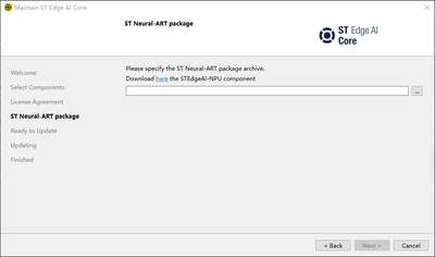

So is there any other solution for now? Can I use another version of stedgeai? For example, 10.0.0,
I can't download ST EdgeAI Core 2.0.0. I need to provide STEdgeAI-NPU component, but I can't find where to download the component? Do you have a solution?
2025-05-16 8:15 PM
I used CubeMX to download x-cube-ai 10.0.0, and finally I also need to provide the stedgeai-stneuralart-10.0.0.zip file. I also don't know where to download it. How can I solve it? Looking forward to your reply, thanks.
