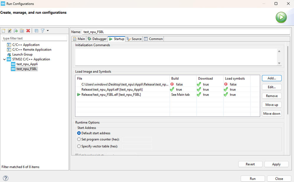

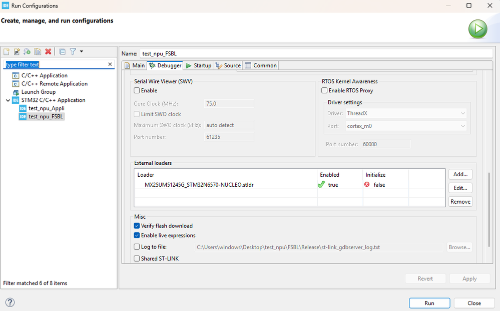

I generated the project, compiled it, and set up the run configuration in STM32CubeIDE as follows:
The first file in the latter figure is a signed .bin file obtained according to the guide here: https://community.st.com/t5/stm32-mcus/how-to-debug-stm32n6-using-stm32cubeide/ta-p/800547
I set to download it at the origin address of the RAM (0x34000400).
