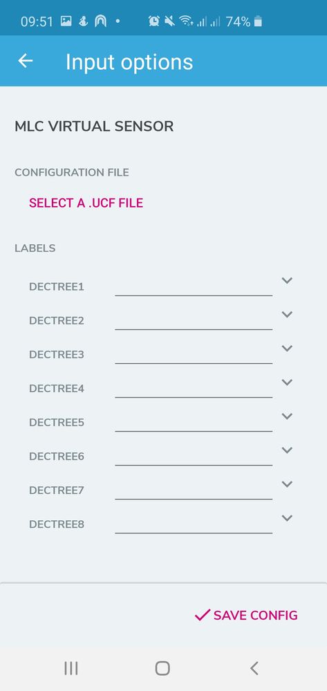

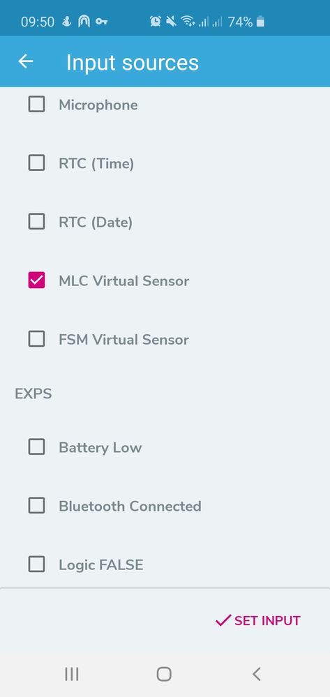

Hi @SFort.1 , @TSchi.2269 , from last week an upgrade of ST BLE Sensor application is available. It implements the MLC virtual sensor (and the FSM virtual sensor) as input source. This feature automatizes the upload of the .ucf file whose generation from Unico is described above and outputs the label recognized by the MLC.
Next step is of course do the whole MLC process on the SensoprTile.box / ST BLE Sensor app, but unfortunately I have no precise estimation of the completion date for this activity.
