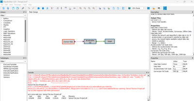

Good morning everyone, I am trying to follow the example for machine learning given for the SensorTile Box
with Algobuilder.
I have followed all the steps with the configuration that did not give problems but when I go to compile the project it gives me this sequence of errors and I cannot flash the SensorTile Box.
Firmware Directory Initialization:
Firmware Directories Successfully Initialized!
Code generation finished successfully.
Build Process Started ...
Create.
Opening 'SensorTile.box-Project'.

What can I do to resolve this issue?
2024-06-20 12:49 AM
Hello @Frabbit
these are not errors but only warnings due to more strict gcc compiler. The binary file is generated and you can program the Sensortile.box.
