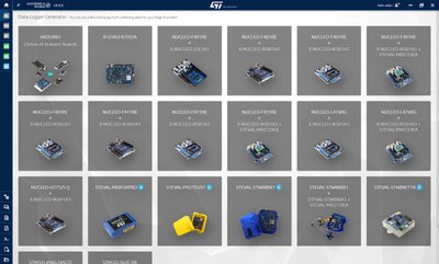

You can also take a look at the Data logger generator; you may be using a compatible board:
https://wiki.st.com/stm32mcu/wiki/AI:NanoEdge_AI_Studio#Datalogger
