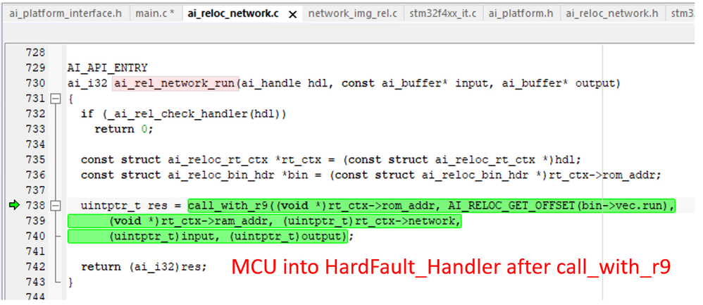

But when I use ai_rel_network_run(), I get into HardFault.
The detailed error information is as follows, with my current test code attached.
Does anyone know how to fix this please?
Thanks in advance.

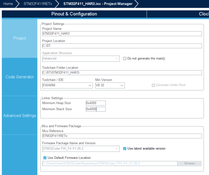

And I had already increased both heap and stack size, but the problem still exists.

Hello WHUAN,
What is the version of X-CUBE-AI tools used?
Since 7.1, the multi-heap feature has introduced an API break to initialize the model.
ai_rel_network_init() expects now a table of pointer for the weights and also for the activations.
ai_handle net = AI_HANDLE_NULL;
ai_handle weights_addr;
ai_handle activations;
const ai_handle acts[] = { activations };
res = ai_rel_network_init(net, &weights_addr, acts))
}br,
