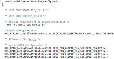

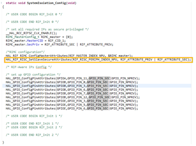

Guide's screenshot:
My screenshot:
I did small address adaptions for the NUCLEO-N657X0-Q
I will attach the project below. Did I make a mistake or is CubeMX not able to configure the NUCLEO-N657X0-Q in the same way it supports the STM32N6570-DK yet? I also tried adding the lines from the screenshot of the guide myself, but it didn’t change the results and I assume there is more missing than is visible in the guide's screenshot. I also assume the missing RIF and RIMC code lines are the main reason why the application didn’t work.
