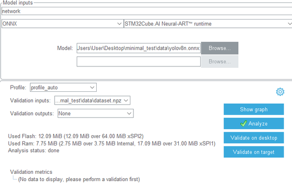

I've updated the model and generated a new dataset.npz file (included in model.zip). When I add this to CubeMX, I’m able to validate the model on my desktop successfully. However, I encountered an issue when trying to validate on the target device STM32N6570-DK board.
Here’s a screenshot of my current CubeMX configuration:
After pressing Generate Code and attempting to build the project, I get the following build errors:
../X-CUBE-AI/App/network.c:7652:41: error: 'inf' undeclared (first use in this function); did you mean 'jnf'?
7652 | const float pad_const_value_native = -inf;
../X-CUBE-AI/App/network.c:7805:41: error: 'inf' undeclared (first use in this function); did you mean 'jnf'?
7805 | const float pad_const_value_native = -inf;
../X-CUBE-AI/App/network.c:7958:41: error: 'inf' undeclared (first use in this function); did you mean 'jnf'?
7958 | const float pad_const_value_native = -inf;
Any ideas on what might be causing this? Let me know if you need any additional details.
Thanks in advance!

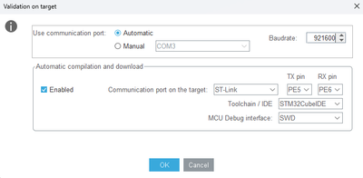

Or via X Cube AI that does the same automatically:
(Don't forget to change the baudrate)
I attached your model quantized with the dev cloud.
