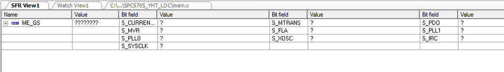

I am working with SPC570S discovery board. I would like to implement the STOP mode to reduce the power consumption and then wake up by using NMI pin like PA[4] or PC[15].
I already entry the STOP mode however the board does not wake up from STOP mode. The program seems to be halted and then showed a warning like this picture.
The mode is then unidentified.
My code is attached in the file below.
Can someone help me to configure the wake up unit from STOP mode?
I am appreciate to your help. Thanks you so much.

Hello ,
According to your code :
Flash is in Low power mode ..
MC_ME.STOP0_MC.B.FLAON = 3; /* Flash is in low-power mode */�?�?
you can not access to the Wakeup function
Maybe ,you should put your function in RAM.
(Standby or Stop Mode) there are nice example in SPC5Studio :
SPC560Dxx OS-Less STANDBY SRAM Test Application for Discovery
SPC560Dxx_RLA WKPU API Test Application for Discovery
You can not debug in Low Power mode.
