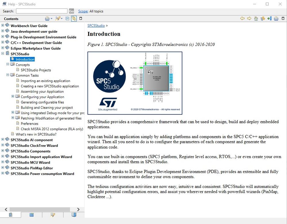

2021-03-02 10:49 PM
please, refer to the help integrated within the tool (Help -> Help Contents). There are specific sections dedicated to SPC5Studio.
Regards,
Luigi
2021-03-02 11:52 PM
Hi
Thanks,
I have gone through the help content and faced following issues:
kindly let me know, where I am wrong.
Thanks
