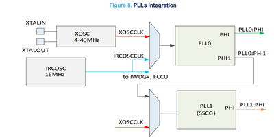

Hello, if I use XOSC freq of 16Mhz, will my max ADC frequency be 40Mhz ? Or will it cause any issues ?
2025-12-14 6:25 AM
the internal clocks you set with the PLL settings, the external crystal or oscillator is just the reference clock.
If you set the PLL and the ADC according...yes.
If you want PLL1 drive by the XOSC , so just take an 40M oscillator as clock source.
