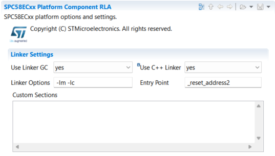

These are my current linker settings:
What do I need to change in my linker settings to get the standard C++ libraries to link/build correctly?

Yes, it is possible but it is not so easy
i recommend to follow to create the missing function in your project
Solved: SPC5Studio cannot use the malloc() and free() func... - STMicroelectronics Community
Best Regards
Erwan
