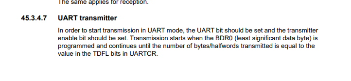

Sorry ,
I do not see any clue except the chapter 45.3.4.7 UART Transmitter from RM SPC582Bx (i assume)
on BDR0
Best regards
Erwan
2021-11-18 3:31 AM
And why are you writing about transmitter while I am asking about RECEIVING data?

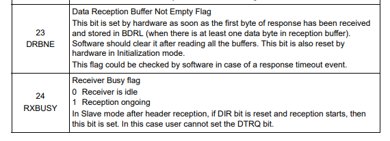

2021-11-18 3:53 AM
Sorry ,
i have missed your first requirement ;)
I see only the check on this flag (RXBUSY)
if RXBUSY (1), Reception is ongoing then started ;)
or maybe RDI Flag.
Best regards
