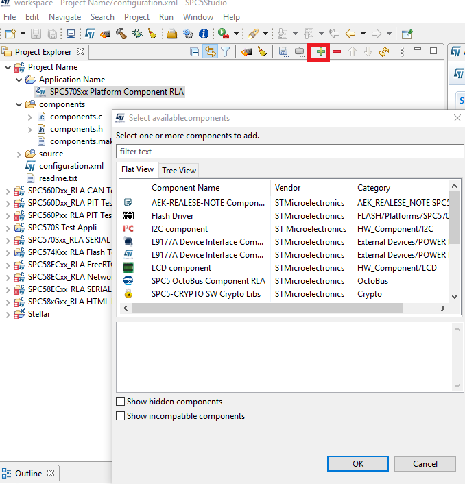

1) First, add the platform component
2) You have to click on the + button to add the compatible component
Best regards
Erwan

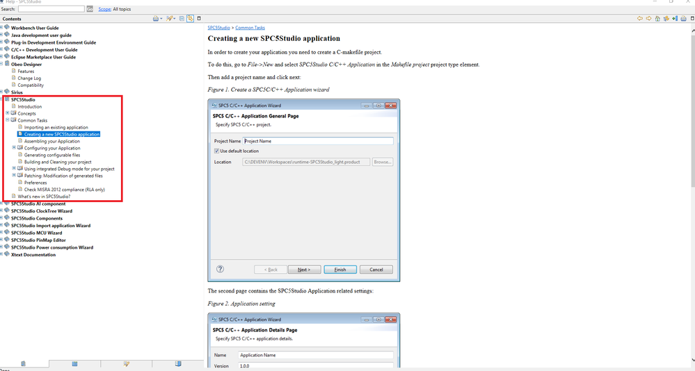

Hello Dinuke ,
There is a help section in SPC5Studio , (Cf Help Section)
you can add any compatible component, configure and generate the code.
Best Regards
Erwan
Hello Erwan,
I followed the help section. I have already created a new SPC5Studion application. I cant unable to find compatible components. Where do I can find the compatible components.
Best Regards,
Dinuke
Best regards
Erwan
