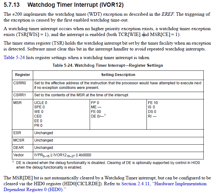

Hello Matthew ,
The watchdog is disabled on SWT IP but not in e200 Core (HW WD)
#if SPC5_DISABLE_WATCHDOG
/* SWT disabled.*/
SWT.SR.R = 0xC520;
SWT.SR.R = 0xD928;
SWT.CR.R = 0xFF00000AU;
#endif
About IVOR12,
the HW Watchdog is enabled by mtMSR (cf boot.s)
* MSR default settings.
#define MSR_DEFAULT (MSR_SPE | MSR_WE | MSR_CE | MSR_ME)
(cf chapter e200z4 document)
