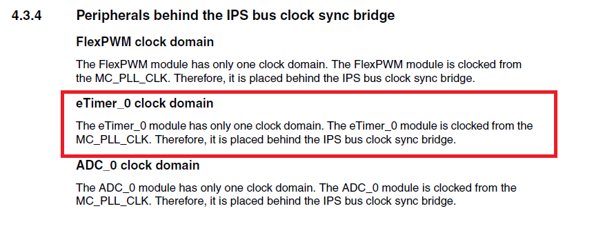

I see in the block diagram of technical datasheet that(Please see attachments) there is option to choose from clock sources: 'Clock' or 'IP Bus clock'
The crystal oscillator frequency is 40M Hz. I would like to use this frequency as input to my eTimer module but i don't know how or even it's possible to get this Frequency routed to eTimer ?
I would be happy if someone can share any useful tips or suggestion in this regard.

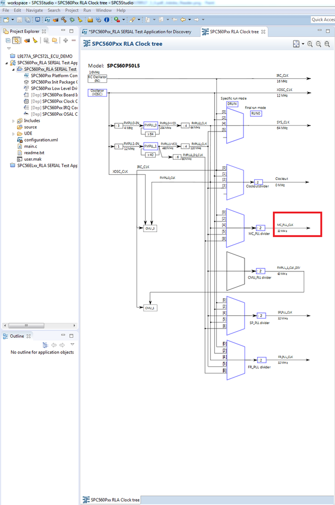

2018-03-23 5:12 AM
Dear Erwan,
Thank you for your reply.
In my project clock tree(Please see attachment) i do not see clock selection logic block for ''MC_PLL_CLK''.
Please let me know how could i add this block and how do i route this(MC_PLL_CLK) to eTimer module instead of SYS_CLK with Prescaler ?
Freundliche Grüßen
Sathish

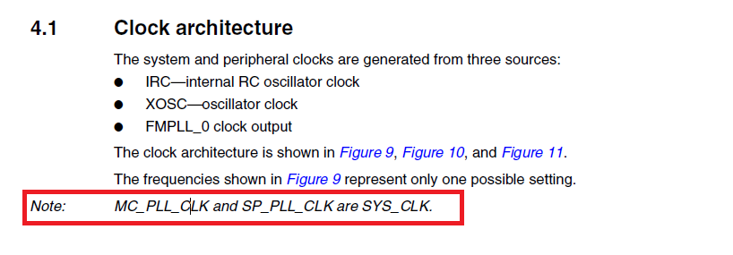

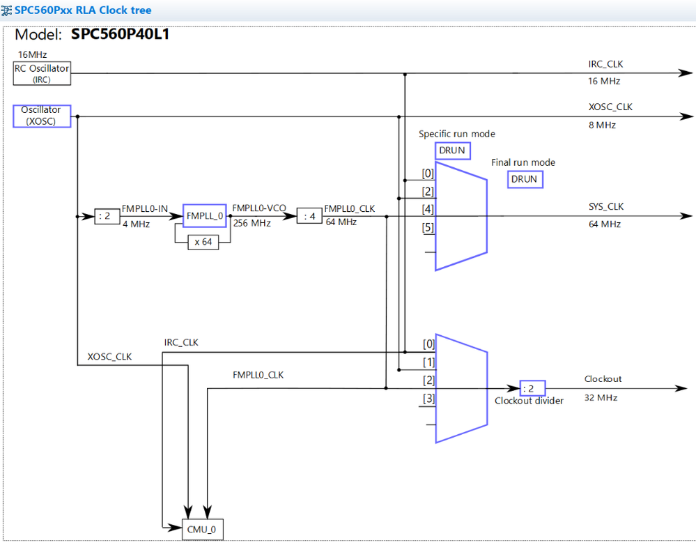

2018-03-23 6:46 AM
Hello Sathish,
for P40 Family, you should take SYS_CLK.
the clocktree is well valid (cf below)
The RM is a game of investigation ;)
best regards
