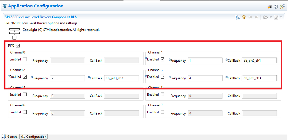

Hello Fahad ,
the initialisation is made by pit_lld_init()
do not forget to configure the pit channel and a good frequency.

Hello Fahad ,

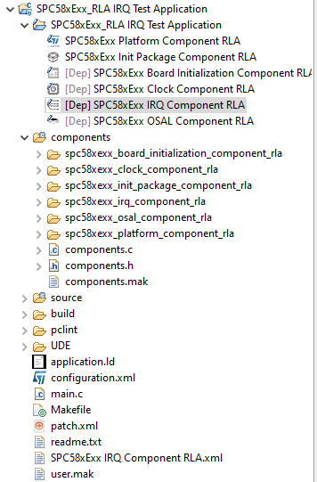

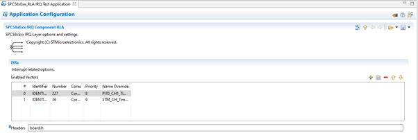

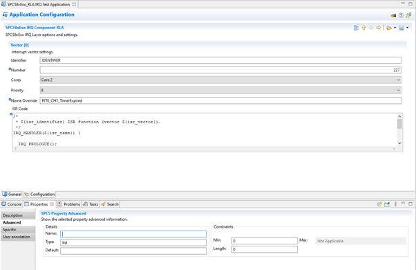

Thanks for the prompt reply. Unfortunately I am not able to find the window, the one you have used for the screenshot. Instead I see the following options and configurations.
In the Project outline I see the following options:
Under IRQ component RLA I see the following configurations:0693W00000GXEoPQAX.png0693W00000GXEoFQAX.pngWhere do I find the low level drivers component RLA window? and which example project are you using?
I used the IRQ exmaple project for SPC58NE series of microcontroller.
