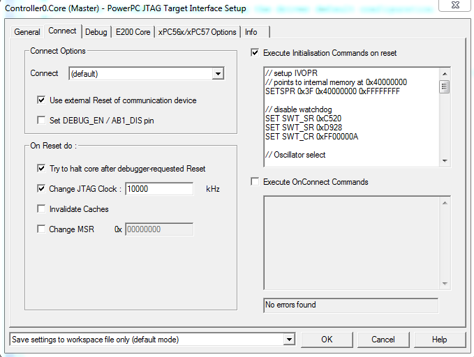

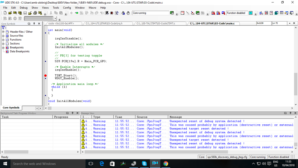

2018-04-10 1:35 AM
Hi erwan , i have removed the watchdog de-init previously . Please see the pic below
Here watchdog reset is happening in 100 ms and i am able to see the warning message ,through
pin state i have confirmed reset time out is 100 ms , but the break point before TIMT_Start()
is not hitting after target reset every time , some times it hits the break point and that also with
different intervals .
