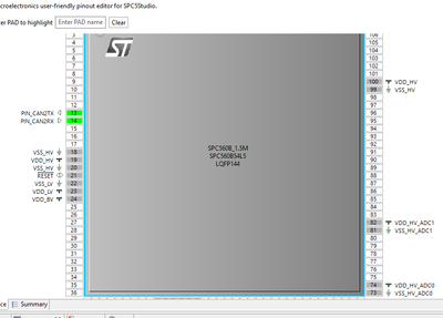

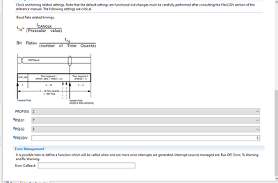

I am trying to use FlexCan with the SPC560B-DIS development board. I ran the example project "SPC560Bxx_RLA CAN Test Application for Discovery," but I didn't want it to operate in LoopBack mode. When I disabled the LoopBack mode, I couldn't read anything from the PeakCan cable. I created a new project from scratch and wanted to send a simple CanBus message, but there was no communication. I am sharing the settings and code from my project in the images. I would be very grateful if you could help. Thank you.

Please select EXTENDED from filter settings and save all filter settings
2024-07-05 7:55 AM
2024-07-05 7:57 AM
It is done, thank you
