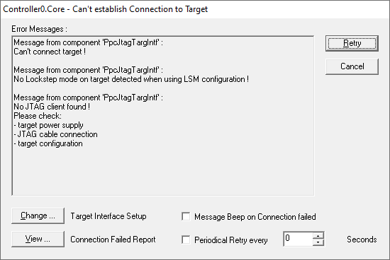

I am setting up a development environment with SPC5-Studio, Discovery Plus Kit for SPC56 L line (with SPC56EL70L5 MCU) and SPC5-UDESDK JTAG debugger.
Initially I was able to set up the SPC5-Studio and upload an example application (LED blinker), but after rebooting my PC the UDE STK tool stopped connecting. No matter what settings I use - the result is the same, the debugger can not connect to the board. I tried reinstalling, UDE and SPC5-Studio to no avail.
To debug the problem I have connected a logic probe to the SPC5-UDESTK pins (TCK, TDI, TDO) and I see absolutely no activity on those pins when I attempt to connect with the UDE STK software.
It seems that the SPC5-UDESTK device stopped functioning correctly. The Windows OS detects the SPC5-UDESTK device correctly.
What can I do to restore the functionality of the SPC5-UDESTK device?

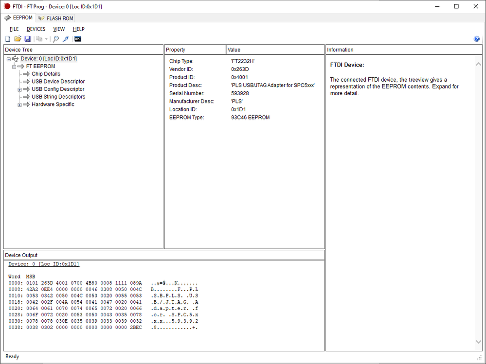

Hello Konstantin ,
could you check your PLS USB/JTAG by FT_Prog
https://ftdichip.com/utilities/ ?
Best regards
Erwan
2022-10-06 9:23 AM
Device is detected. What I should be looking at?
XML template is available here: https://pastebin.com/raw/Dtbc9RAv

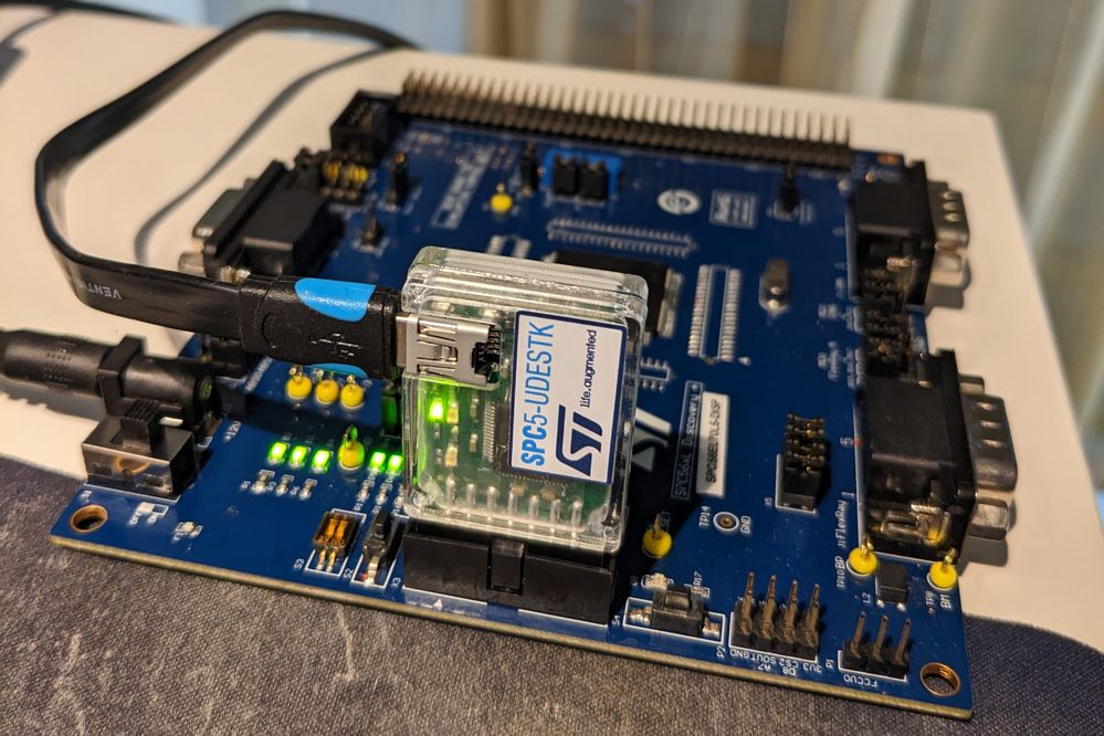

Photo of the device, connected to the EVB:
