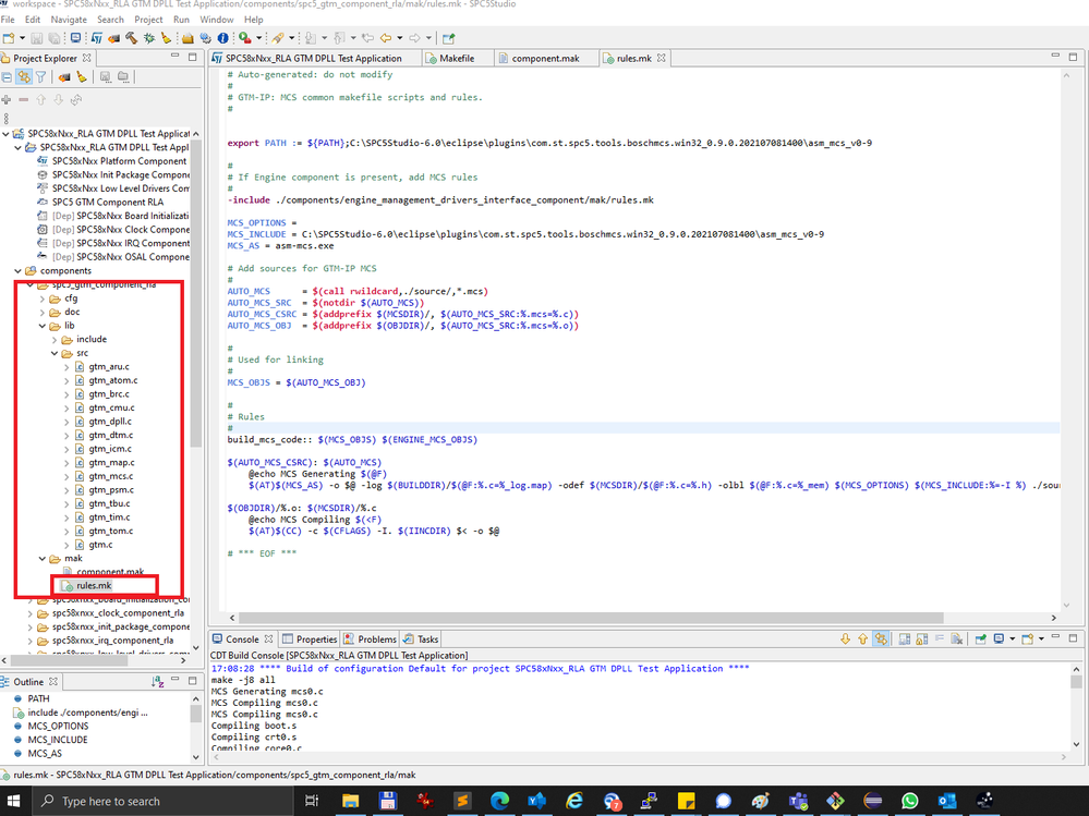

We have a project running with TIM input signal and ATOM outputs and are now trying to use the MCS, we have looked at the GTM DPLL Test application and done some modification to the MCS program. Are there any tricks or options needed to compile the MCS program with SPC5?

You can check the rules.mk located in spc5_gtm_component_rla.

Hello Lhase ,

Yes we found the rules and have it up and running with the compiler now.

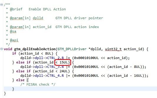

I quick look in the reference manual and the registers when running shows that in GTM_DPLL_CTRL_3 it´s not possible to enable AEN15 however we try.
It turns out that the gtm_dpll.c file need a slight adjustment < 15UL should be changed to < 16UL (attached picture)
Now everything is up and running as it should, and yes 2 mcs on this one but we plan to use all 3 mcs on the SPC574K soon.
