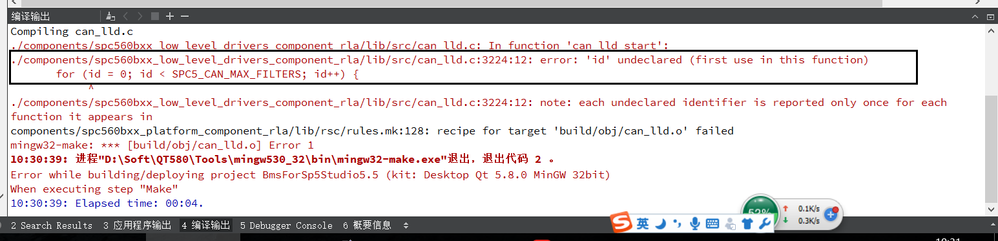

1.The CANConfig structure adds a number of field information,it have a ''fifo_rx_callback'' function point.
. Why is there a dialog box in SP5Studio that does not configure fifo_rx_callback?Causes the '' fifo_rx_callback'' function point to NULL

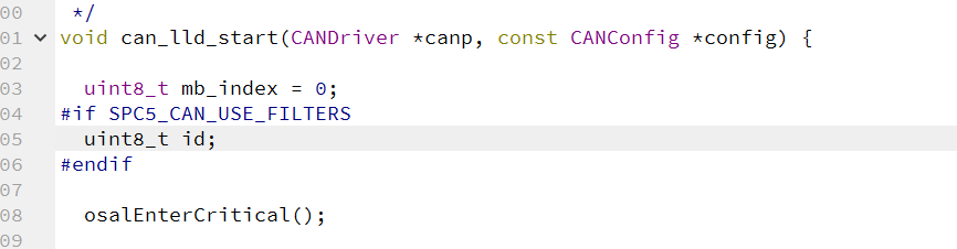

2. Building failed when disenable CAN filter.
this is a bug

Regarding point 1)
Currently the FIFO is supported only on Pictus and it's going to be introduced in other platforms. You are using bolero B platform so you cannot see FIFO configurator yet but the driver already support it. In the next version FIFO configurator will be available also for your platform.
Reagrding point 2)
As already said, an ER is opened and issue will be solved in next release . Meanwhile, please change can_lld.c file with the attached one.
Best Regards,
Procolo

Hello Guo ,
i am submitting an ER (Error Report) for this issue
Best regards
Erwan
