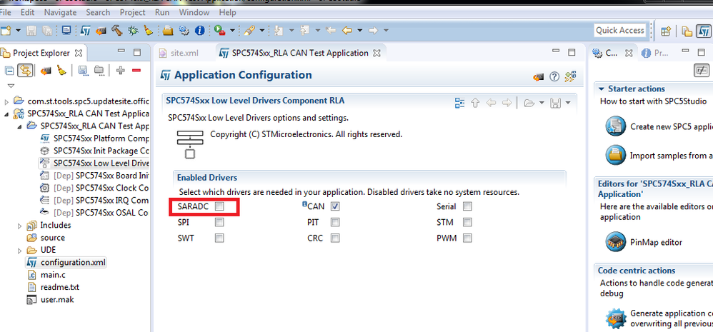

I am using SPC570s-Disp eval board and I want to activate the SARADC lld's. I have selected it in the Low Level Drivers Component RLA page, as shown in the screenshot. However, in the MCU wizard tool, it is still shown as inactive (again given in the screenshots). In the code (saradc_lld.h and saradc_lld.c) it seems like the driver enable switches for all the channels (SARADCD12_1, SARADCD12_2 etc.) are undefined.

2018-07-16 2:14 AM
Hello Erwan,
I have enabled the SARADC lld, as shown in capture.png in attachments. It still remains inactive in the MCU wizard.
