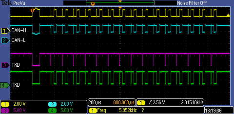

EDIT:
I am getting directly after transmit with "buffer" set to a TXD buffer this signal on the bus:
(obviously CANoe is sending error frames)
I discovered when I do a non fitting initialization of message boxes but with a number less than the MAXMB value then I get this signal instantly after FLEXCAN_0.MCR.B.FRZ = 0U during init.

I think that there is a problem in pads configuration.
Please configure the right RX and TX pads as showed in the below example:
  /* Setup FlexCAN 0 pins */
  /* TX (PB0)
    PA = 1 (AF1) / OBE = 1 / ODE = 1 / WPE = WPS = SRC (min value) = 0 */
  SIU.PCR[16].R = 0x0620;
  /* RX (PB1)     IBE = 1 */
  SIU.PCR[17].B.IBE = 0x1;
Best regards
