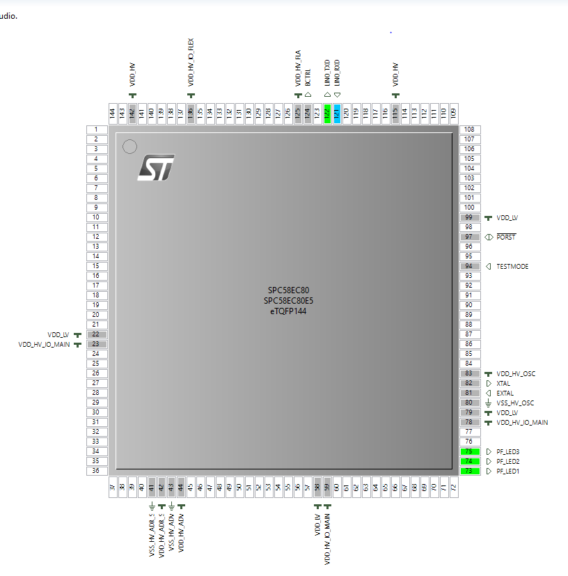

This is the pin setting by default for the SPC58ECxx_RLA_SERIAL Test Application for Discovery example code. Should I change the pin settings here inorder to get this application running ?
2022-11-10 8:18 AM
Configure the chip to have the serial input/inputs in the normal manner.
Perhaps output a stream of characters so you can scope the signal.
Connect the directionally appropriate input/output signals to counterparts on the USB to CMOS Serial adapter that YOU have selected.
In the electric sense and output needs to go to an input.
