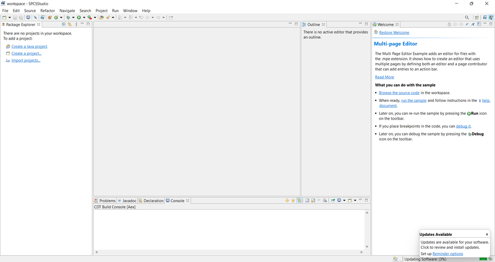

2022-10-24 11:04 PM
Hi all,
Thank you for the answer. I downloaded the new version and installed. Now I cannot locate the Project wizard.
2022-10-25 12:19 AM
click on icon "open perspective"
and choose "SPC5Studio default"
Best regards.
2022-10-25 12:29 AM
Thank you. It worked.
