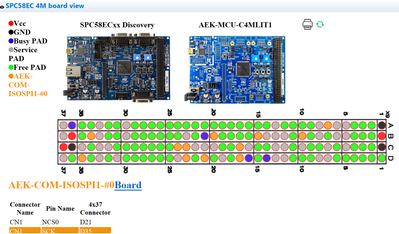

Inside AutoDevKit Studio you will get the complete code and information including the wiring information, just by activating the BoardView.
Download AutoDevKit Studio from www.st.com/autodevkitsw
At the end you need to connect only the AEK-MCU-C4MLIT1 MCU board with the transceiver board AEK-COM-ISOSPI1 by wiring.
Then the ISOSPI1 board is plugged in the USB-like connector directly in the node board AEK-POW-BMS63EN.
Use the AEK-MCU-C4MLIT1 mcu board for SPC58EC microcontroller.
Once you open AutoDevKit Studio import for the AEK-MCU-C4MLIT1 example for BMS, generate the project and open the board view (few screenshots below).

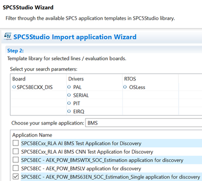

You can try AutodevkitStudio or SPC5Studio (AutodevKit) (PowerPC)
with a combination of AEK_POWBMS63EN / AEK_COM-ISOSPI1 / SPC58EC
There are some nice examples in the application wizard

2024-01-26 11:23 AM
