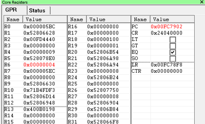

2024-08-19 2:05 AM
Thank you very much for your response. Following your advice, I used a debugger tool to check the R13, R14, and PC registers. The strange thing is that even though function calls are continuously made, the value of the R13 register remains fixed at "0x400B0198" and the value of the R14 register is fixed at "0x00000000," without any change. Additionally, this picture is a core register capture taken when a system crash occurred. What should I analyze in this situation? And if this is indeed a stack buffer overflow, what methods can be used to resolve it?

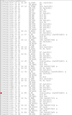

Thank you for your response. I have identified the exact point in the code where the crash occurs. The crash happens when the code at address "0x00FC7902" within the "MontyJacProjAddPoints" function is executed. At that moment, I have captured the core register values, which are attached in the photo.
Based on this information, can you analyze the cause of the crash? Is it possible that this is due to a stack overflow? This is a critical issue, and a thorough analysis is necessary. Thank you for your assistance.
2024-08-20 7:41 PM
Based on my analysis, it seems that data should be loaded from the memory space at R27 + 0xC, but since R27 contains "0x00000008" it results in accessing an invalid memory location, causing a crash. I suspect that this issue might be due to a stack overflow. Is this correct? Additionally, if it is indeed a stack overflow and we can no longer increase the stack space, what should we do?
